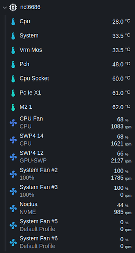

if everything was good, you should see something like this (or similar) on your coolercontrol

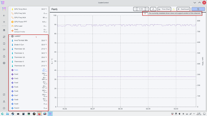

Yes, they are detected with warnings (from pwm1 to pwm7 same error):
WARN  coolercontrold::repositories::hwmon::fans] PWM fan at /sys/class/hwmon/hwmon7/pwm1 is NOT writable - Fan control is not currently supported by the installed driver.
However, I can’t manually control them due to the error shown in the screenshot above.
