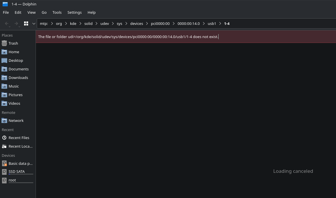

I'm trying to access files from my phone but dolphin shows this error. My phone is xiaomi 13pro+
i already posted this topic week ago on reddit and didnโ€™t have an answer for this.

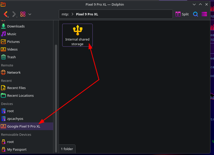

This is a common issue with Xiaomi devices on Linux.
What Iโ€™ve seen others do is, Check USB Mode:
Ensure your phone is set to โ€œFile Transferโ€ (MTP) mode, not โ€œChargingโ€ or โ€œMIDI,โ€ after connecting the USB cable.
Then Restart Dolphin and look again.
If the error persists, change the USB function in your phoneโ€™s notification panel to โ€œChargingโ€ or โ€œMIDIโ€, wait a moment, and then switch it back to โ€œTransfer Media Filesโ€.
If the Phone is connected and the screen is on run:

Mine is set to Off file transfer.
Now on for files:
And Please check your Xiaomi 13 Pro+ is unlocked and you have tapped โ€œAllowโ€ on the phoneโ€™s permission popup when connecting.

I already did that and still seeing the error.

Now i connected to cable that i was using for tranfering files from phone to windows and i still got the same error.
The file or folder udi=/org/kde/solid/udev/sys/devices/pci0000:00/0000:00:14.0/usb1/1-4 does not exist.
