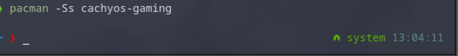

Then run this command and post the output:
pacman -Ss cachyos-gaming
Yeah, I see it now. You’re missing a repository.
Can you post the contents of /etc/pacman.conf?
You should see something like this:
[cachyos-v3]
Include = /etc/pacman.d/cachyos-v3-mirrorlist
[cachyos-core-v3]
[cachyos-extra-v3]
[cachyos]
Include = /etc/pacman.d/cachyos-mirrorlist
For some reason, you seem to be missing the [cachyos] repository, which is where the gaming meta packages are located. So we just need to fix your pacman.conf which we can do once we see what the damage is in there.
