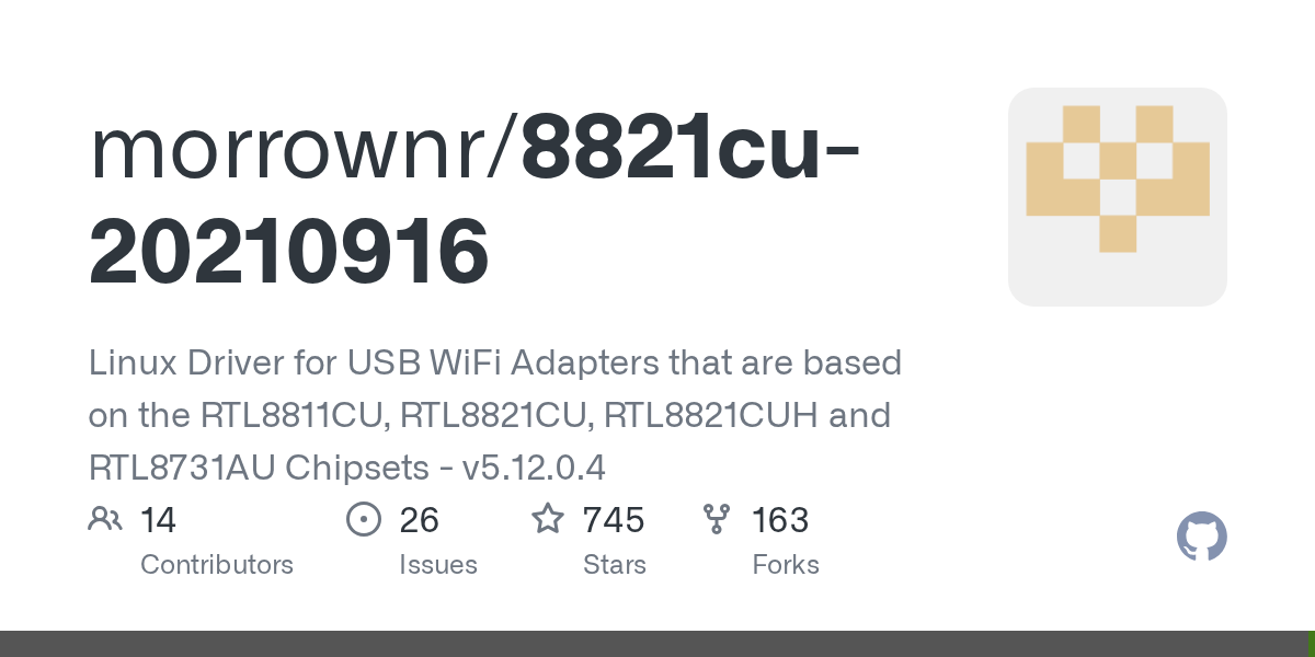

sudo pacman -Syu rtl8821cu-morrownr-dkms-git

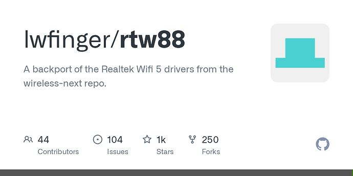

If you want to use the actual kernel, then maybe the RTW88 DKMS might work
It’s also in the AUR as rtw88-dkms-git (but sadly not in the ChaoticAUR)

I’m wondering why you suggest the rtl8821cu or the rtw88 modules should wirk with the wifi?(which is a 13D3:3306 IMC Networks Mediao 802.11n WLAN [Realtek RTL8191SU])
I tried rtl8821cu-morrownr-dkms-git and it did not work. Should it?
rtw88 is a DKMS of the kernel module, that should work with every kernel
