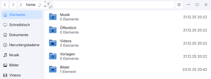

How to get rid of a nameless file manager?
I have CachyOS with Cinnamon. It comes with Nemo as the file manager. Some actions though open a different, mostly featureless, anonymous file manager:
What is this? It has no about or any hint. How to get rid of it?

A lot of apps have a built-in file manager. That looks like Nautilus. Is this device-wide or from a specific app? Can you isolate it with htop or similar?
Stupid me, typing “file” in the start menu reveals the name: “cutefish”
grafik
I wonder why this is on my system. The repo did not see any commit in 4 years. sudo pacman -R cutefish - done.
@dwouu It opens if I click on the file form a firefox download.

Is this possible? I certainly did not install it. I didn’t even know it’s name.
Maybe you can check the pacman.log to see when it was installed and what else was installed at that time?!
here is the log:
~ $ grep -E "cutefish" /var/log/pacman.log
[2025-12-21T14:10:16+0100] [PACMAN] Running 'pacman -Syu cutefish-filemanager'
[2025-12-21T14:10:29+0100] [ALPM] installed cutefish-filemanager (0.8-3.1)
[2026-04-22T17:51:13+0900] [PACMAN] Running 'pacman -R cutefish'
[2026-04-22T17:51:21+0900] [ALPM] removed cutefish-filemanager (0.8-3.1)
If this install command was triggered by me I should see a doctor.

Here is was happend around the install:
~ $ grep "cutefish" /var/log/pacman.log -n5
1986-[2025-12-21T14:05:12+0100] [ALPM] running 'gdk-pixbuf-query-loaders.hook'...
1987-[2025-12-21T14:05:12+0100] [ALPM] running 'gtk-update-icon-cache.hook'...
1988-[2025-12-21T14:05:13+0100] [ALPM] running 'update-desktop-database.hook'...
1989-[2025-12-21T14:05:13+0100] [ALPM] running 'zz-snap-pac-post.hook'...
1990-[2025-12-21T14:05:13+0100] [ALPM-SCRIPTLET] ==> root: 43
1991:[2025-12-21T14:10:16+0100] [PACMAN] Running 'pacman -Syu cutefish-filemanager'

I started this by installing calibre:
[2025-12-21T14:04:45+0100] [PACMAN] Running 'pacman -Syu calibre'
Can such an install “drag” an extra file manager?

Says nothing about a cutefish… although I don’t know about the dependencies of all the dependencies :wink: I doubt that calibre would bring its “own” filemanager. Then again, you never know.
To recursively see ALL dependencies, you could use pactree calibre (when it is installed) or pactree -s calibre (to look it up in the database).
says quite clearly “do a system update and then install cutefish-filemanager”. I have no idea who did that on your machine. Try history | grep cutefish to see if it might have been you.
I doubt it was Calibre that did anything, but not something I can say for certain.
I found the Internet Archive snapshot from the Arch Extra repo from that exact day, and cutefish-filemanager is not there, nor in any of its dependencies around that period. There are not that many snapshots of cutefish-filemanager itself, so I cannot say if it was not briefly required by something at that moment in time.
It has nothing to do with calibre.
That line of pacman -Syu cutefish-filemanager pretty clearly shows it being installed intentionally and solely with no other reason or purpose (aside from the sync/refresh/upgrade it was combined with).
The only way I could see this as not committed by the user would be if it were part of the install process .. as these go through different loops of install groups .. but even then we would probably expect to see it along with other packages and not just by itself.
That or something entirely missed - like a GUI frontend and clicking what is required to commit an install for cutefish.
But whether a GUI or pacman in a terminal .. it would very much seem it is something that was performed intentionally and then forgotten about.
Thank you for the clarification. I guess I suffer from amnesia then :face_in_clouds:. Anyway, I learned a lot here.
Thanks to all.
I know that feeling of amnesia. My tip for everyone: start a “diary” where you write down all the changes you do to your system. Sounds tedious, but it’s actually very helpful. Just the other day it helped me with a very similar case of amnesia.
