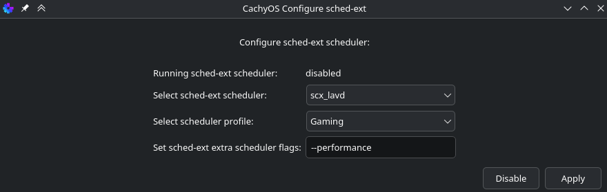

If no difference, you could try a different CPU scheduler. Ananicy must be disabled for this. Easiest way would be to run “SchedExt GUI Manager”. For example, try scx_lavd with Gaming profile, hit Apply:
Any difference? See wiki for more info: sched-ext Tutorial | CachyOS

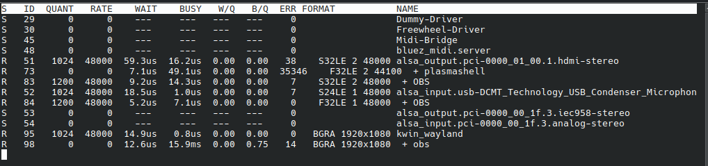

If you run pw-top (presuming you are on pipewire) you can sometimes see audio delay audio / errors
Open a terminal and run this:
pw-top

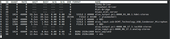

alright so this is what shows up in pw top, the largest number (obviously the 35k) increases as the lag spike hits, it also just increases when im not even in a game
Interesting that the main errors appear where you are uniquely sampling 44100. Might be worth setting that to 48000 like everything else and testing.
