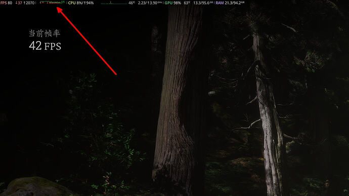

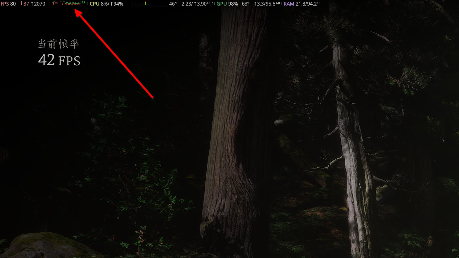

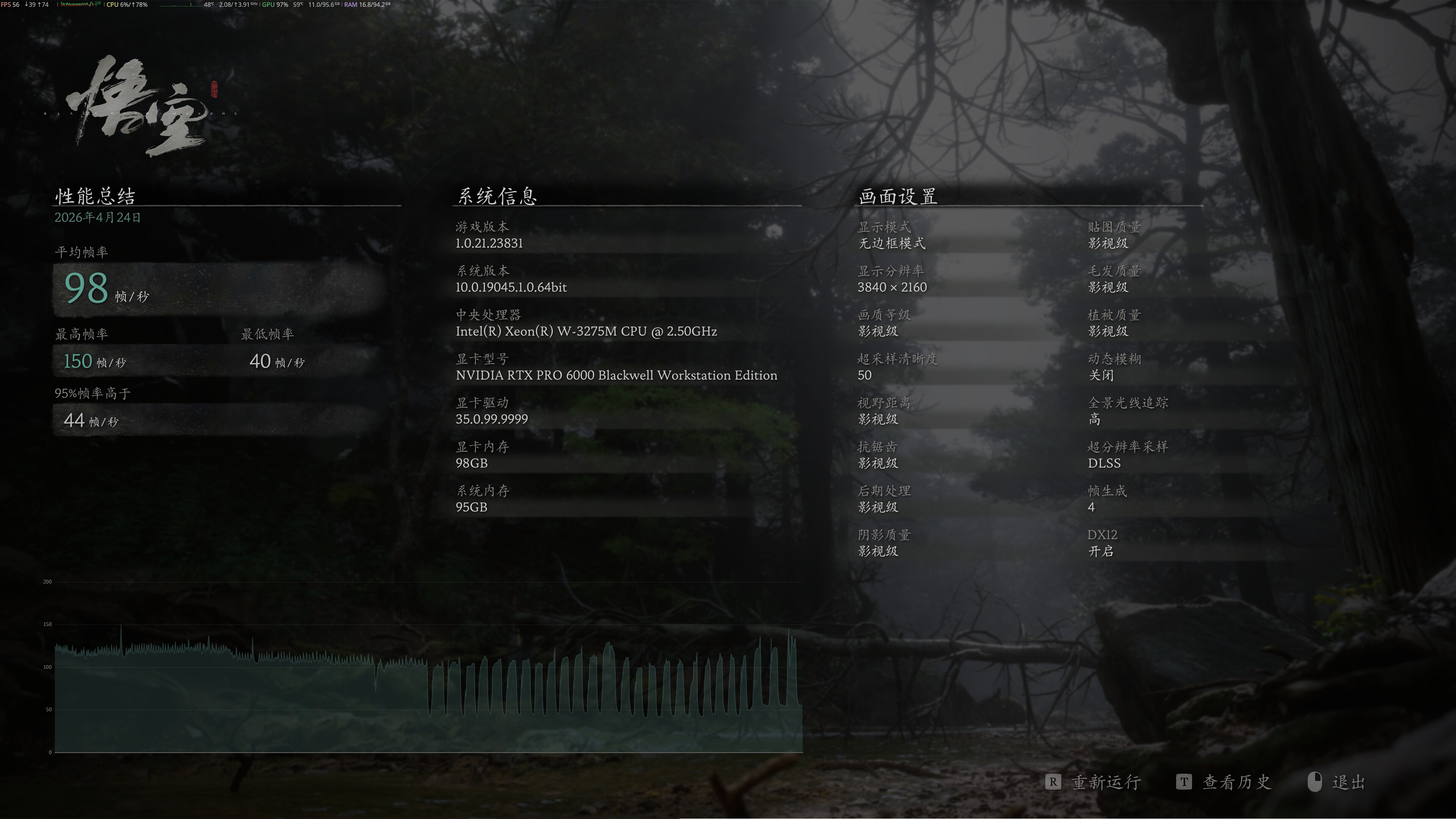

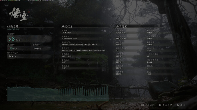

I have Cachy-Update enabled and perform rolling updates on a daily basis. In the past 1–2 days, I’ve noticed that games start dropping frames in a certain pattern after a few minutes of gameplay. I originally thought it might be related to proton-cachyos-20260420, so I downgraded to proton-cachyos-20260409, but the issue still persists. I used to have stable fps between 120-150.
I used Black Myth: Wukong as an example, but the issue also occurs in other games like Cyberpunk. The issue is also reproducible using Wukong’s built-in benchmark.

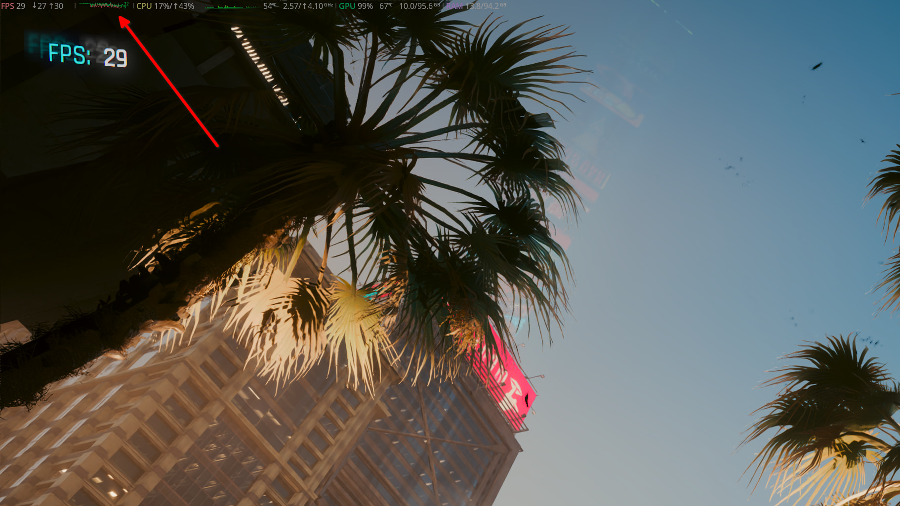

I tried again with frame generation disabled with very minimal launch options VK_DRIVER_FILES=/usr/share/vulkan/icd.d/nvidia_icd.json prime-run %command%. The issue is still happening in Cyberpunk. I disabled adaptive sync too. I also tried different sched-ext scheduler and BORE kernel.

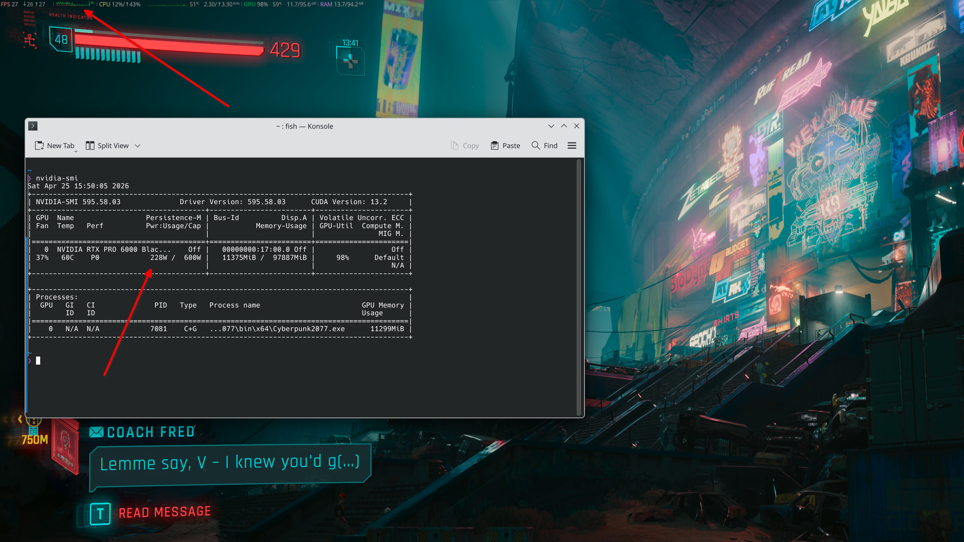

One interesting observation is that the game never pulls more than 300W now. It used to pull 500W+ with no problem. I just ran a few LLM models, and my Mac Pro can sustain 600W with no issue. I wonder if the gaming driver profile has some problems. The PRO 6000 Blackwell has two variants: one is Max-Q, which is rated at 300W, and the other—the one I’m using—is rated at 600W.

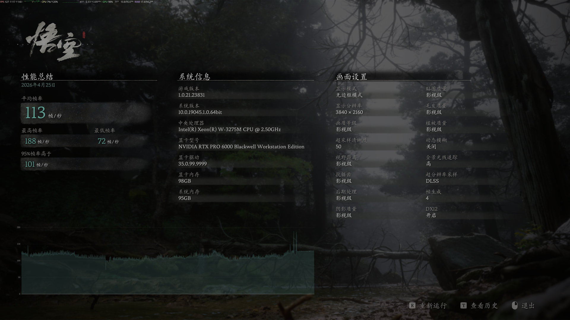

I found the issue. Recently, I asked my local AI agent to integrate Rust’s nvml-wrapper into T2FanRD so that my NVIDIA GPU could get more fresh air from the Mac Pro’s front intake fans during high LLM inferencing workloads. I never imagined this would cause a gaming performance regression, since the fan program was working as expected, responding to GPU temperatures, and CUDA computation performance was still great. After I stopped the T2FanRD systemd service, the benchmarks looked great again, and my GPU can now pull over 500W of power. I need to review the AI-generated Rust code to see what might have gone wrong.
