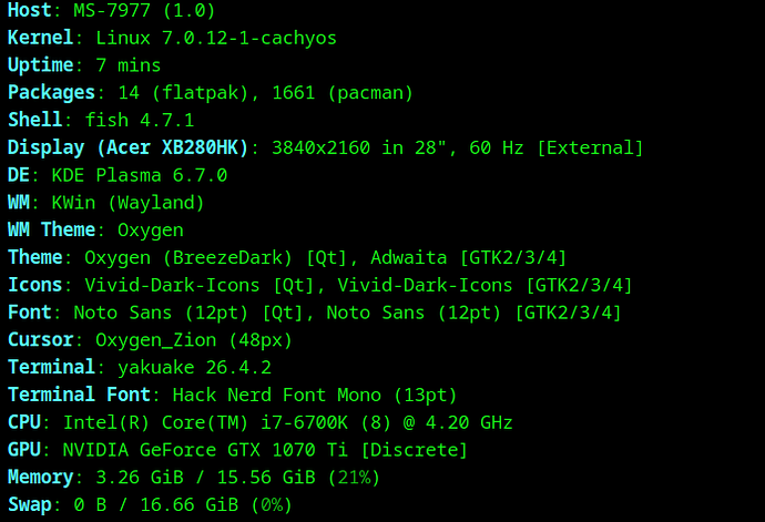

Freezes with intensive games
Hi. I’ve been recently having trouble with intensive games freezing, which started a few days ago. It started with games like cyberpunk (via heroic), not even making it to the main menu. I’ve tried different versions of proton (cachy-slr / GE / experimental ) with no change. Again, I tried the trench lord demo on steam, and it stutters as it gets to the main menu, and then freezes. I booted in to windows 10 (shudder) and the same demo loaded fine.
I have a suspicion this started around the KDE 6.7 update, but that may be a coincidence.
CPU temperature seems to be getting high too.
I’m not sure how to diagnose this one, so any help would be appreciated.
Using nvidia-580xx-dkms 580.159.04-2 driver.
To add, audio continues playing, whilst the graphics freeze. Older and less intensive games run fine (so, bataman arkam city, disco elysium, citizen sleeper (heroic)). For some reason, 40k rouge trader (steam) stutters and freezes at main menu, even though there’s no real graphic use.
To get out of this, I change tty (so ctrl+alt+f3) and force a restart, with ctrl+alt+del. The terminal itself doesn’t show.
I just can’t figure out what has changed to cause this. :man_shrugging:
As a last attempt to get some help, I was patient and tty3 showed up, and I could log in. btop showed the process was idling at about 2%. Switching back to kde worked once, but a second time, it stuttered and froze. So, GPU maybe? Odd, as it works in windows.
