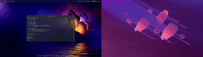

I do have Secureboot disabled, and nVidia is set to Persistence-M
I also have in my Bios a Swicthable Graphics mode enabled.
 xrandr -q
Screen 0: minimum 16 x 16, current 3840 x 1080, maximum 32767 x 32767
eDP-1 connected primary 1920x1080+0+0 (normal left inverted right x axis y axis) 344mm x 193mm
   1920x1080    120.17*+
   1440x1080    120.14
   1400x1050    120.13
   1280x1024    120.09
   1280x960     120.02
   1152x864     120.11
   1024x768     120.02
   800x600      119.85
   640x480      119.52
   320x240      119.73
   1680x1050    120.08
   1440x900     120.20
   1280x800     120.18
   1152x720     119.94
   960x600      120.04
   928x580      119.87
   800x500      119.91
   768x480      119.71
   720x480      119.65
   640x400      119.64
   320x200      117.55
   1600x900     120.18
   1368x768     119.99
   1280x720     120.04
   1024x576     120.15
   864x486      120.10
   720x400      119.54
   640x350      120.03
HDMI-A-1 connected 1920x1080+1920+0 (normal left inverted right x axis y axis) 575mm x 323mm
   1920x1080     59.88*+
   1440x1080     59.87
   1400x1050     59.86
   1280x1024     59.76
   1280x960      59.79
   1152x864      59.78
   1024x768      59.68
   800x600       59.86
   640x480       59.38
   320x240       59.29
   1680x1050     59.85
   1440x900      59.89
   1280x800      59.81
   1152x720      59.75
   960x600       59.63
   928x580       59.88
   800x500       59.50
   768x480       59.38
   720x480       59.71
   640x400       59.20
   320x200       58.14
   1600x900      59.82
   1368x768      59.88
   1280x720      59.86
   1024x576      59.90
   864x486       59.45
   720x400       59.27
   640x350       59.28
Do you have any tips or advice to how i could fix this issue? I dont my laptop has a MUX switch so i am contemplating removing everything that is about hybrid graphics and just always use my GPU but i am not sure. Also dont know what i would need to remove.
Any help would be appreciated, as i am pulling my hair out with this issue!
