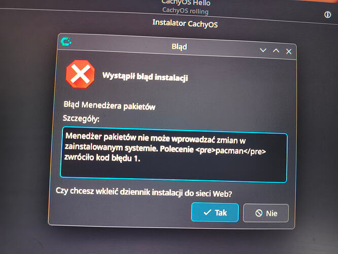

Hyprland don’t working anyone maybe know the problem?
I want change from kdeplasma to hyprland but when its 37% i get this problem
The problem is here:
2026-05-30 - 15:26:58 [6]: [PYTHON JOB]: ":: unable to satisfy dependency 'libaquamarine.so=10-64' required by hyprland"
