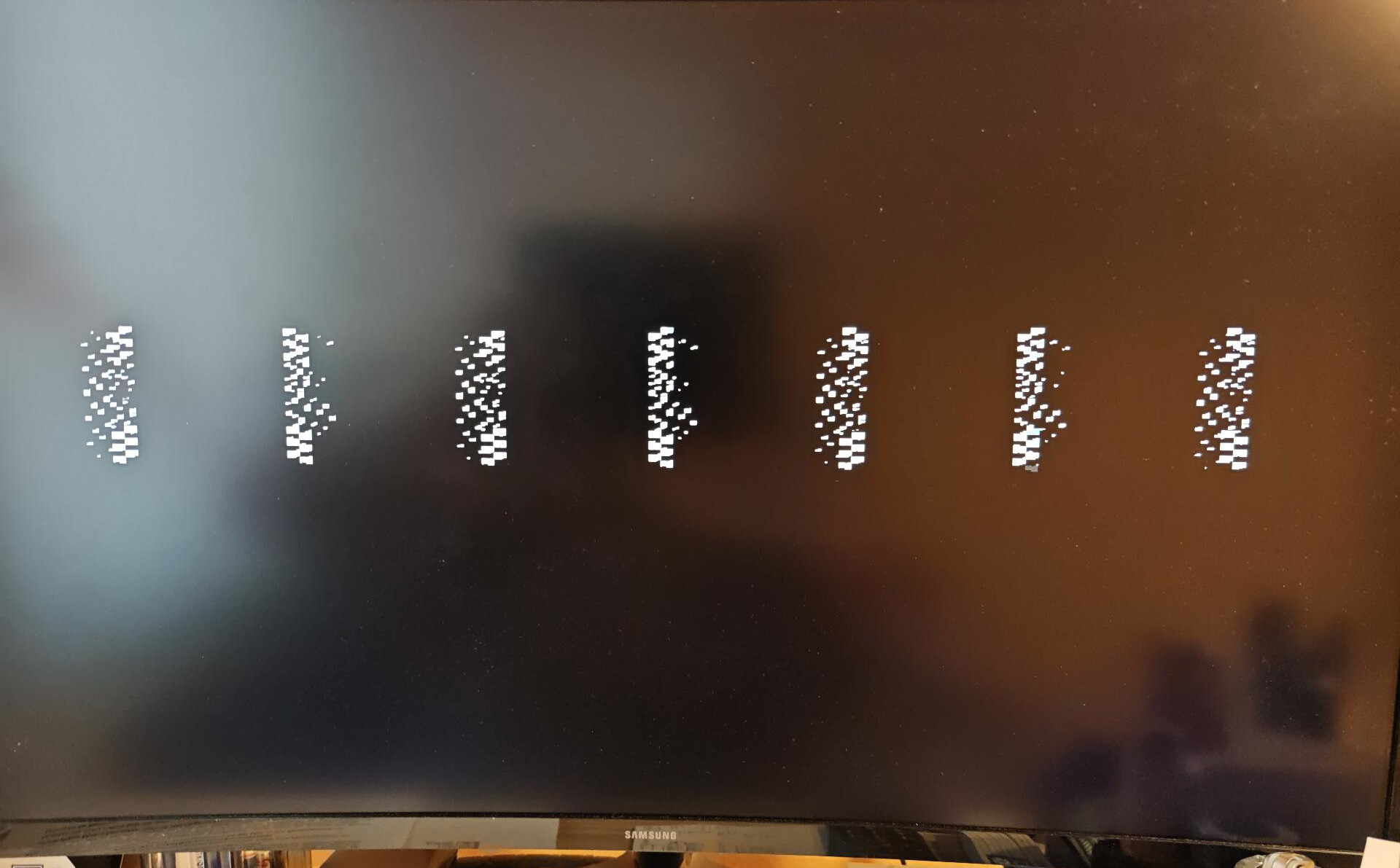

GDM was only installed because SDDM is not working properly. I’m using KDE as the desktop environment, and SDDM is causing problems (which is why GDM was installed in the first place). Sometimes I have to restart the PC two or three times before the login screen appears; before that, I only get windows with graphical glitches/errors. What can I do about this? I already had a post/thread here about it before, but unfortunately it didn’t lead to a solution. Maybe someone still has an idea.

I’m having a problem with sddm (see image), which is why I used gdm on my PC for a while. Everything worked fine until the day updates stopped working. I don’t know why an Albanian server is being used; I didn’t configure anything after the installation. Currently, gdm is removed from the system, and I’m experiencing the exact same login problems when I use sddm. So, it must be a problem with sddm that the login window only appears after the second or third restart, and before that (see image above), there are always errors. I’d like to use sddm since I’m also using KDE.
