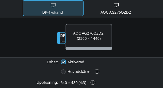

I did the installation and everything im still a bit new to linux and i have this 200hz monitor but whenever i plug the other cable which is stated by the name “DP-1” it goes into being 640x480 and there is no other options for this. Im using an hdmi cable and its handling it right now with 144hz but i really wanna get the full potential of my hardware. What should i do?

Wayland handles display overrides directly inside your desktop settings. Go to your System Settings → Display and Monitor. Click on the broken DP-1 screen. Sometimes, the resolution dropdown is just glitching in the UI—try changing the “Orientation” to rotated and back, or toggling “Adaptive Sync” (FreeSync/G-Sync) on and off. This can force Wayland to re-read the monitor capabilities.

Thank you for the advice, i am running wayland and i have tried your solutions both on top and on the wayland part of your suggestion but unfortunately it stayed the same, refusing to change anything and the adaptive sync option was not even available when i put it in. I have an MSI MAG 274qpf e20 wqhd 200hz and i was trying the displayport cable that came with the monitor. Again, thank you very much for the suggestion, it was worth a try.
I have the same problem but with my second monitor fortunately.. Its an old AOC 1080p that only has DP. And there’s nothing wrong with the cable. I also tried the solution here but it doesnt work..
