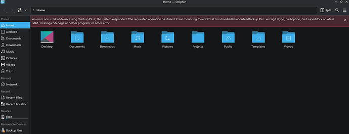

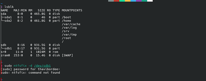

According to your answer, I still have the same problem.
This is the error that I got when I click on my ext. hdd.
and this is error message from terminal.
Please provide the result of “lsblk -f”. You might also want to check the drive is accessible by attaching it as an external USB or directly to another Windows machine.
Hi and welcome. First of all, a little request: please post text instead of screenshots whenever possible. It is easier to read and to quote.
Regarding your issue: to me, this sounds pretty much like the HDD was not unmounted properly from Windows (== the “dirty bit” is still set).
If you still have a Windows machine around, open a terminal as administrator and run
sfc /scannow
and
chkdsk -f
on that drive, maybe also DISM.
See documentation:
This normally helps.
@anon15508052 What is ntfsfix? Never heard of it and neither pacman nor paru are able to find it anywhere…
It’s bundled in
1 cachyos-extra-v3/ntfs-3g 2022.10.3-2.1 [577.51 KiB 1.65 MiB]
    NTFS filesystem driver and utilities

Finally, I found the solution, but I’m not sure if this is the right solution or not.
I tried the alternative mounting method. I used the ntfs-3g driver explicitly.
sudo mount -t ntfs-3g /dev/sdb1 /mnt
I would have fixed it first before a force mount.
@anon15508052 I got it! I will fix it first. Thank you very much.
Didn’t I read somewhere that ntfs-3g is deprecated? And that ntfs3 is now part of the kernel? Could also remember that wrong, though.
You read right! but the Utility’s are missing from the kernel driver.
