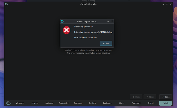

Can't Install "Failed to run pacstrap"
I feel like I have exhausted every option. I have looked at dozens of posts here, Reddit, wherever… No fix seems to help. I have spent a combined total of 8 hours reading online articles, plugging random terminal commands from the internet and Claude just trying to install. I feel this is the only place left to post, and hopefully someone can help me out.

Not the OP, but I am encountering the same issue. I am not trying to dual boot. I am running a fresh install from the 04-26 Desktop Live ISO using “erase disk” and I’m getting the “Failed to run pacstrap” error message as well.
here’s the log file generated on my last failed attempt:
I have tried resetting the keyrings as well as ranking mirrors but that doesn’t seem to help so I’m really at my wits end here.

Here’s a new log for this latest attempt. I’m not very knowledgeable about how pacman and the installer work together, but it looks like there are issues when downloading the packages from these server mirrors:
https://cdn77.cachyos.org
https://mirror.krfoss.org
I don’t think this has to do with an incorrect system time, since this is handled by the CachyOS Live installer…
With both of you the installation fails at the same point - trying to get gcc from cdn77.cachyos.org.
This has been noticed before - this thread has the possible solution: Installation Error: Failed to run pacstrap
Looks like instead of removing these mirrors from the rankings, we need to block them in the HOSTS file. Interesting.

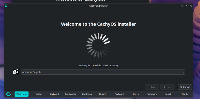

EDIT: Removing these entries from the mirrorlist using the sed command only caused the installer to hang on the initial step: “waiting for 1 module (x seconds)…”. It keeps waiting forever.
I had to add additional mirrors that failed on the latest attempt. Here’s a new log:

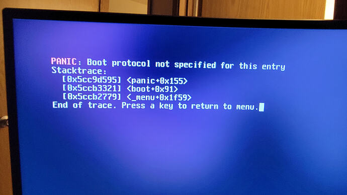

That got me past my Pacstrap error, but I received a new error. The installer just… Closed. Then when I tried to boot into Cachy this is what I got.
I admit I am unfamiliar on these results and will do some research, but if someone can shed some light that would be appreciated.

Are you sure you have Secure Boot switched off and are not using Legacy?
