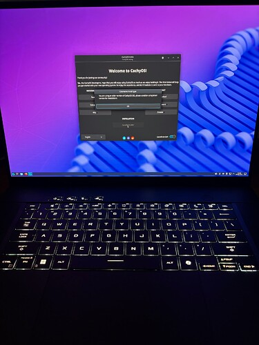

I regret implying anything negative here. However just so we’re clear I took a moment to start the installer as supplied and here’s a phone camera shot of the old version warning I referred to :man_shrugging:
I’ll try to post a shot of the ‘missing’ zfs features I referred to if/when I see it again :+1:
update- Ok, I’m not seeing the zfs features fields that I claimed to earlier. Of course the machine froze several times while taking a look. This hardware certainly doesn’t like old kernels. I’ll try to retrofit new kernel into the 250828 ISO on my lunch break and report back if I ever see them again although I don’t expect to get support for such a hacked setup.
