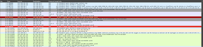

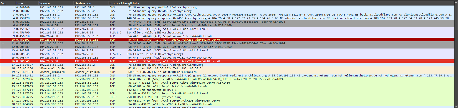

I wrote a script saved as /sbin/ping that always returns exit code 0 when pinging 8.8.8.8, aiming to bypass the ping check. Why does cachyos.org return RST, ACK packets when CachyOS Hello subsequently tries to access it, causing CachyOS Hello to conclude that the server is unreachable? However, I can normally open cachyos.org in my browser.
