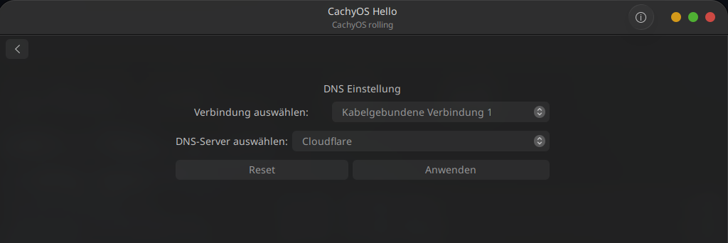

is there a way to disable the CachyOS DNS Settings here in Hello App?

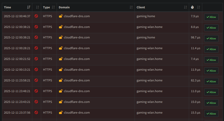

Through Pihole i noticed that Cloudflare DNS Server get pinged a lot by CachyOS. Can i just disable or uninstall this tool?

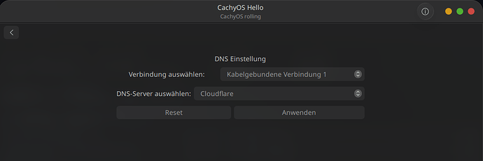

are you sure that is the dns you are using? check in network mananger and see what it set at. I just checked mine and i am using my pfsense router which is where my dhcp is located. When i bring that dns hello up, it says the same thing but isnt what i am using.
I dont think there are the kinds of buttons you are looking for there.

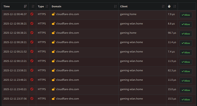

But here you can see, that CachyOS still tries to contact Cloudflare DNS:

Hello App’s DNS section limits options to predefined providers (like Cloudflare, Google, etc.) and doesn’t have a direct “none” or custom entry, which is why you’re seeing pings to Cloudflare (1.1.1.1) via Pi-hole.
You don’t need to uninstall anything drastic like the Hello App itself (it’s just a frontend for common configs and harmless to keep). Instead, configure your DNS at the NetworkManager or systemd-resolved level to use your Pi-hole/Unbound setup. This will bypass the Hello App’s suggestions entirely

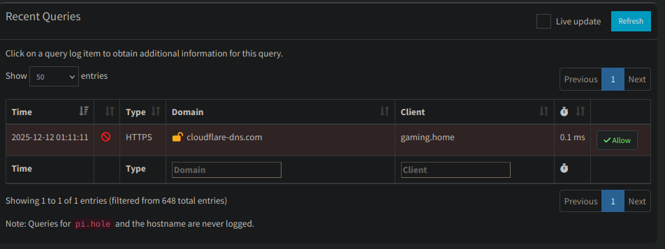

looked like i celebrated too early:

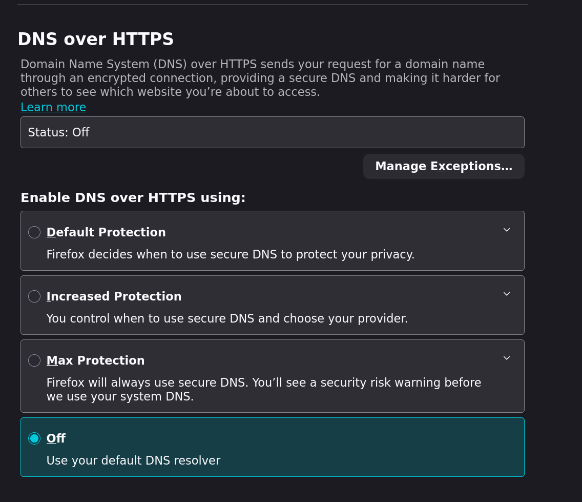

And this is also besides your browser .. most big browsers today implement their own DNS, bypassing the system configs, unless disabled.
Ex, part of firefox;
Imgur
Yes thats already turned off, thank you.
