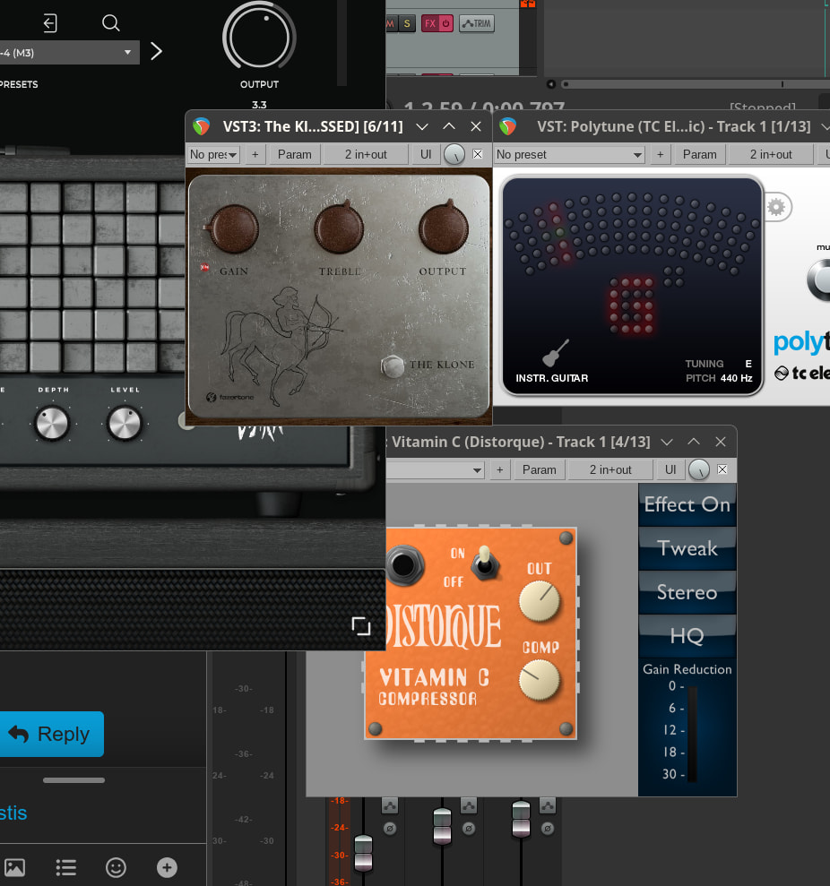

using reaper jabridge and the newest wineversions
for wine i need to activate an emulated screen via winecfg
the bluescreen needs to be present on the desktop, you can bury it under other screens but yeah…
its working but wished it would be easier
Thanks buddy I did end up at blue screen zone but changed it back. Setting desktop to emulate virtual ill try again. I hope this gets fixed as cachy is the perfect os apart from wine
on retrying I did get a couple to work keyzone classic, but most still unusable, prob got enough linux native plugs anyway now :slight_smile:
