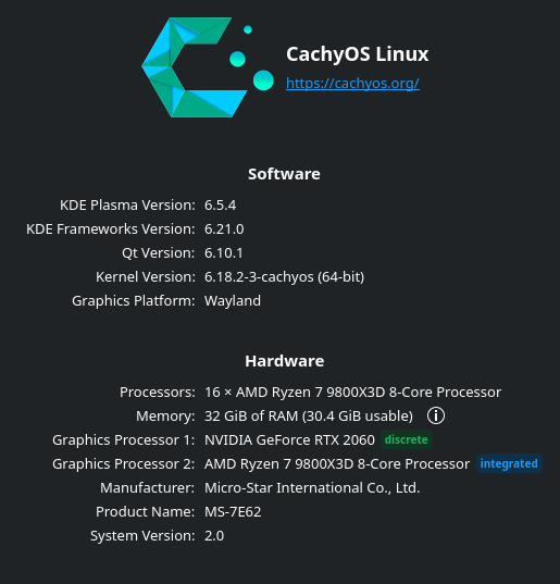

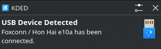

Hello! I am a relatively new CachyOS user, and this is my second post. This is a fresh install of CachyOS with the gaming packages and a handful of apps from the CachyOS Hello app I am running.
I have run into a strange issue I would rather attempt to resolve than ignore as I don’t fully understand the implications of this particular part being broken in my computer. At the bottom right of my screen a notification will pop up every few minutes that reads “USB Device Detected Foxconn / Hon Hai e10a has been connected.” from KDED. I did some surface level searching online and haven’t found anyone with this exact issue. Any help or pointers would be much appreciated.
I have so far attempted a Cold Boot, but have avoided making any changes to configs or putting in any commands myself.
Attached is the bugreport file, a screenshot of the error popup in question, and the “about this system” page in system settings if that helps.

I have decided to mute the notifications through the popup itself, my setup as it stands is a little unstable to begin with it seems. I’ve managed to get everything set up and working until I finish putting together the last few parts of this PC, and will get into permanent fixes and solutions after everything is set and in place. I did attempt to uncomment those two lines in that config file and it didn’t seem to have an effect after restarting, so I went back to the config and reverted the changes I made just in case.
Thank you for your help! I will tackle the core of the issue in the future (assuming an update doesn’t fix what may just be a niche hardware thing interacting with the OS in a weird way)

I am curious about the specs, I have a feeling it may have something to do with the exact motherboard I’m using. I won’t be much help unfortunately but I’d imagine a random passerby may eventually come to contribute/review this and it may help them as well.
This is my current Motherboard: MSI MAG B850 TOMAHAWK MAX WIFI AM5 AMD B850 SATA 6Gb/s 5G Network Wi-Fi7 DDR5 Motherboard
I’m also using a MSI motherboard - MSI PRO X870-P WIFI (MS-7E47) REV 1.1 with AMD X870 chipset to be exact. Unfortunately, MSI’s website doesn’t specify neither the make nor the model of wireless network card used for this motherboard. They only advertise that it supports Wi-Fi 7 and Bluetooth 5.4. Running the lsusb command doesn’t yield any more information. It only returns Bus 001 Device 003: ID 0489:e10a Foxconn / Hon Hai entry for the onboard Bluetooth adapter. So that’s that. If anyone wants more information, tell me which commands should I run. I’m not a complete beginner. I’ve been using Linux on and off for about 8 years

Can somebody see a package, that has anything to do with bluetooth?
It is defenitly a problem with the MSI MAG Tomahawk WIFI AMD X870. I saw several users who reported the issue with Bluetooth.
I am guessing it should be a problem with every motherboard that has the Foxconn / Hon Hai chip on it.
I would suspect these packages:
[2025-12-15T21:40:42+0100] [ALPM] upgraded bluez-qt (6.20.0-1.1 → 6.21.0-1.1)
[2025-12-15T21:40:47+0100] [ALPM] upgraded networkmanager (1.54.2-1 → 1.54.3-1)
[2025-12-15T21:40:47+0100] [ALPM] upgraded networkmanager-qt (6.20.0-1.1 → 6.21.0-1.1)
