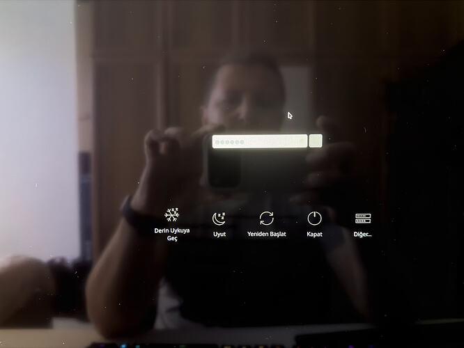

Hi Sethur,
I am experiencing the exact same trigger on my setup, though the visual result is slightly different.
If I boot up my computer while my monitor is turned off and then turn it on once it reaches the login screen, the UI is completely broken. Instead of just a black screen and a mouse pointer, my background is completely black but the password input field and the bottom action buttons are actually visible. However, entering my password does nothing, and clicking any of the buttons is completely unresponsive.
You can see exactly what my screen looks like here: **
It is highly notable that you are having this issue on an NVIDIA RTX 4070, while I am running an AMD Radeon RX 9070 XT. This strongly suggests the bug is tied directly to the new Plasma Login Manager or how KWin Wayland handles late display initialization, rather than a specific GPU driver issue.
