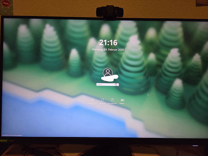

there must be somewhere, maybe in some discrete location after you select your name? can you take a photo?
My CachyOS is in german, is that a problem?

I use a different login manager, I don’t know where is it on this one. Are you already logged in? You have to be logged out to select a new session. It should be hidden behind some of the buttons. Idk kde is too autistic for me.
I finally found a drop down menu in the bottom left :wink:
