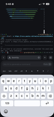

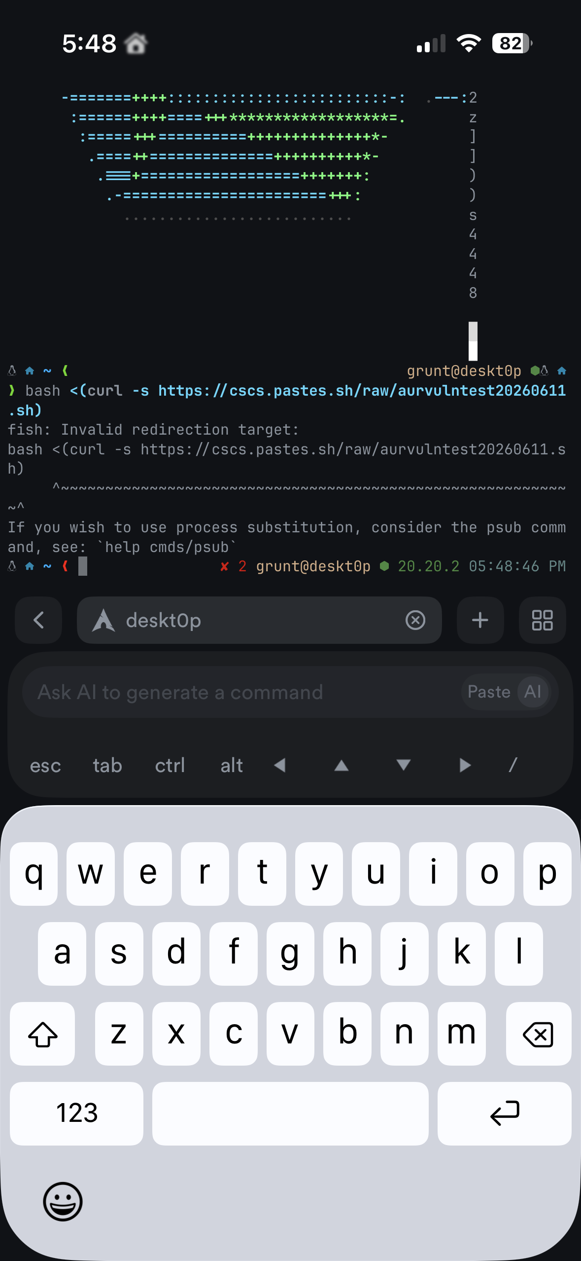

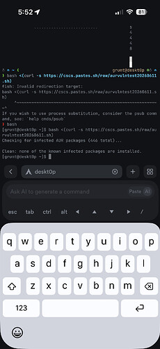

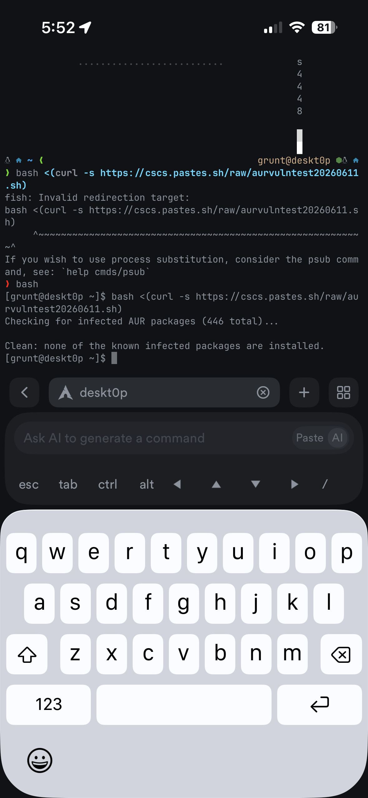

Not working either. Very possible my phone is doing some weird copy/paste stuff (remoted into my arch desktop to check as I try and put kids to sleep.
Fish thing maybe?
Edit: yeah. Fish thing. Changed prompt to bash and it worked.
