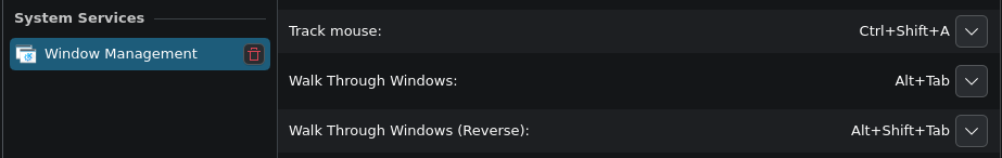

The major one is that no window manager shortcuts work! That is a bugger :slight_smile: ! I am looking at the shortcut dialog in keyboard section of the settings, and none of those specified work.

I have no hint for the Alt+Tab, though, as it just works on all my KDE systems. I guess you mean these?
Yes. None of the shortcuts work. I have to use the touchpad and mouse cursor to do any windowing operation.
