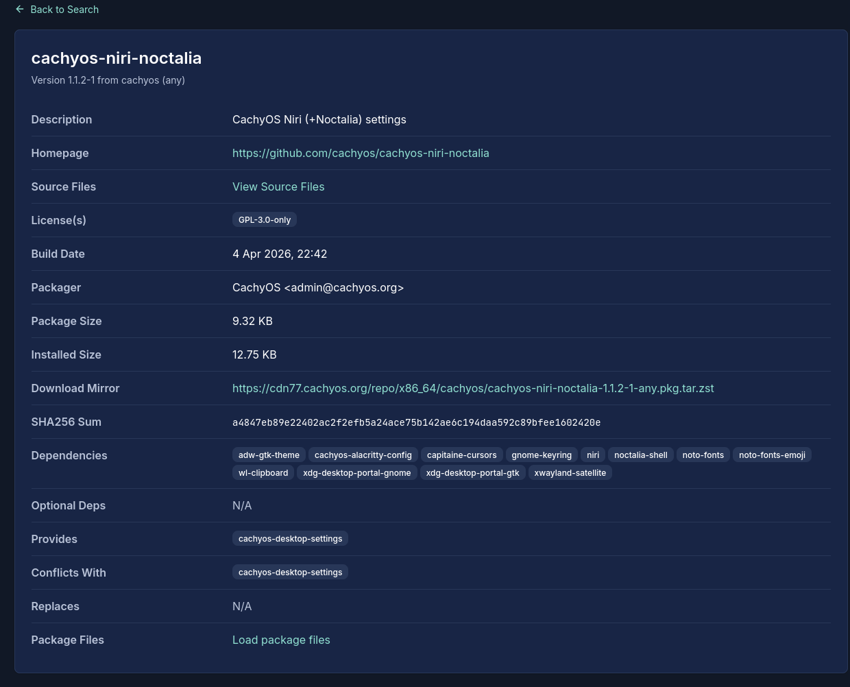

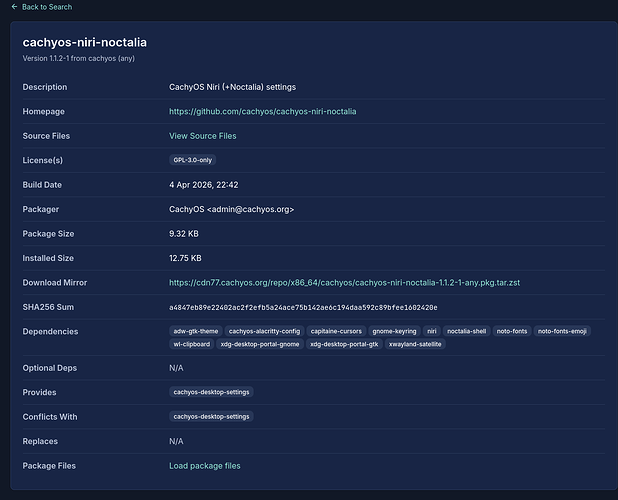

I don’t remember installing cachyos-alacritty-config so I checked in the CachyOS package repo and indeed its a dependency for cachyos-niri-noctalia:
