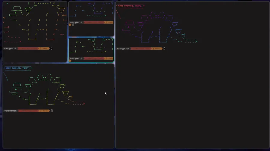

  • Terminal emulator choice is vital here, especially if you want to use TUI software. The default alacritty does not support sixel out of the box (sixel handles displaying images in terminal emulators). I am thinking of looking into ueberzugpp as a possible solution atm.
