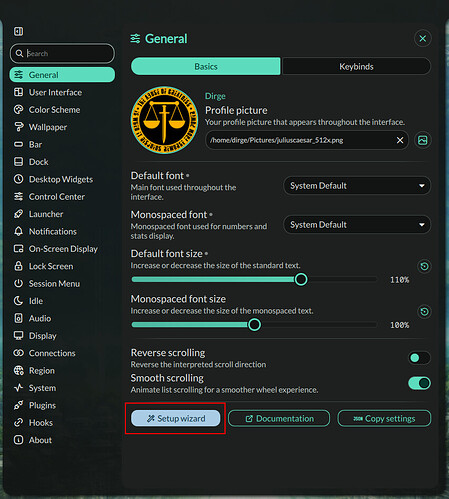

  2. Noctalia’s first start setup wizard is not activating at the moment. I’m trying to get it turned back on even though I’m starting it off with a settings.json already placed in its config directory, but no luck yet. In the interim, you can and should manually activate the setup wizard yourself by clicking this button in the settings panel:
