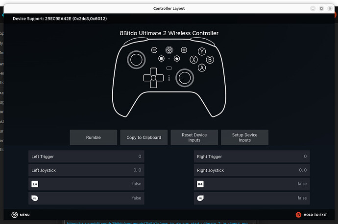

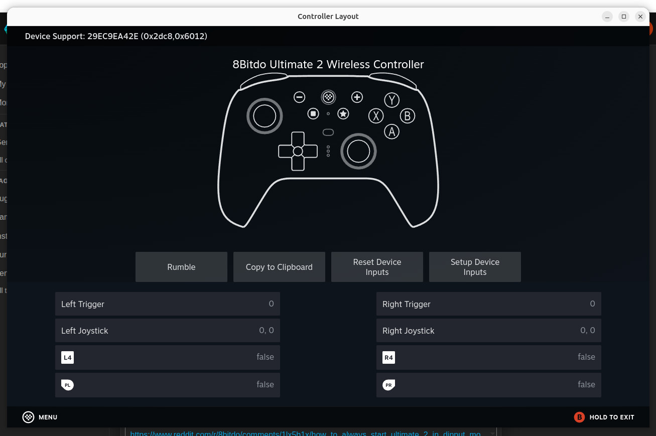

Hello.
After power it on with dinput, you need to put it on the dock to save dinput configuration. Worked for me.
Source: https://www.reddit.com/r/8bitdo/comments/1lx5b1x/how_to_always_start_ultimate_2_in_dinput_mode/
