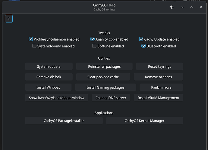

in the cachy os hello app, do some tweaks. i used to have this same issue . now its completely fixed and i never have to worry
can you give me the details of the tweaks you did.

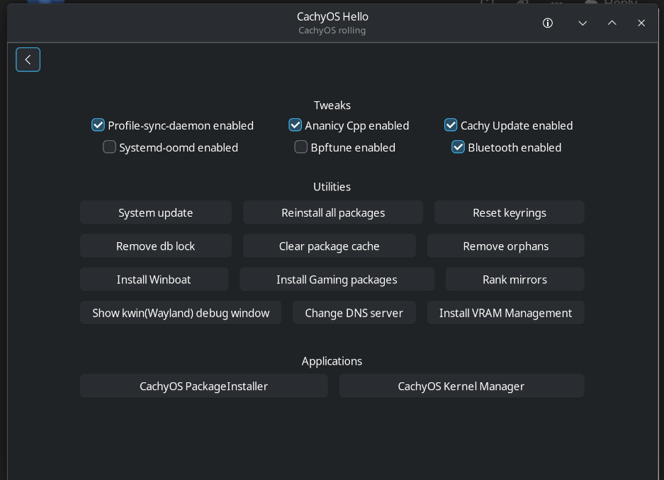

check this out
Thanks , will confirm when the solution works
If am not wrong, nothing on these settings are related to sleep.

Yep, Cachy-Hello settings are not at all related to sleep. Sometimes newcomers on Linux want to help but don’t have enough knowledge to do it…

oops . then how is it fixed on my system after changing these settings? but i have seen this laptop freezing after waking up problem more common on cachy os and cachy devs arent taking it seiously
It’s not related to CachyOs but to kernels, and or acpi tables, and or GPU firmware, and or wakes up of some component or modules.
So please don’t blame CachyOS dev!
I repeat that Cachy Hello doesn’t aim at all to set sleep up, so it’s probably a kernel or GPU firmware update which have fix your issue.
