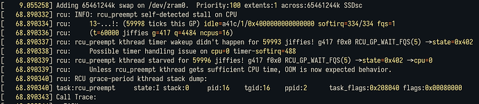

Taking a second look at your dmesg output, there’s a huge(?) jump in time at 9.05… to 68.89… This is right when/after it says:
Adding 65461244k swap on /dev/zram0. …
Then it mentions a “self-detected stall on CPU” … related(?) to the rcu_preempt
It mentions rcu_preempt a few more times and even that “OOM is now expected behavior”.
OOM means “Out of Memory” (insufficient RAM, etc.)
How I would approach this is to assume that the zram0 compression is somehow failing or not working out at least. Maybe it’s just taking too long.
Even though the time lag might not be fully logged, it does mention a “grace period” (a pause) and maybe even an error log dump (which takes time). Maybe there’s a huge error log somewhere? Or it doesn’t have enough RAM after the OOM to even to a log? IDK.
However, what I would do next is try the system without zram, (no RAM compression) and instead use an ordinary swap file or a SWAP partition.
If you have enough RAM, you could possibly even try no swap, but I’d only try that as a last resort since the error message already mentions OOM.
Let us know how it goes if you try that.
Tried disabling HD Audio Controller in BIOS — no improvement in boot time. Also tried removing zram (emergency mode on boot, reverted). Also tried blacklisting snd_hda_intel and removing plymouth from mkinitcpio hooks — no improvement.
The HDA Intel error in dmesg at 68s seems to be a symptom, not the cause. The ~3.5 minute gap before local-fs.target starts remains unexplained.
Still investigating. Any other ideas welcome!
