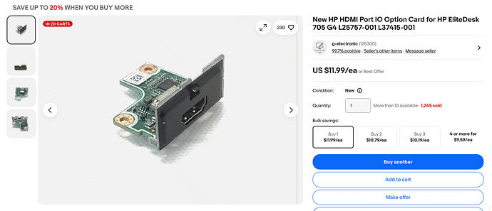

Will give it a shot! I know you said you got it working with the DP, so that’s cool, what kind of monitor? I also ordered the HDMI flexio to see if that helps. Will keep trying to get it to boot via the normal method.

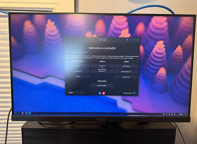

So it worked with the FlexIO HDMI adapter: HP HDMI Port Flex IO (705)
Same exact cachyos ISO, now no eternal blank screen, booted into the launcher.
