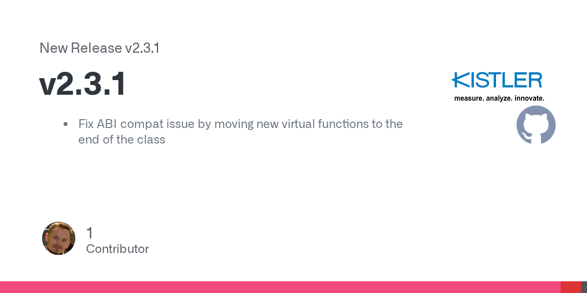

I’ve heard that the ArchLinux community expects a fix by later today.
I’ve figured out how to re-compile hypridle on my own fixing the issue whilst waiting for the official fixed binary.
With a working system snapshot to restore my system config if it all went horribly wrong, I did the following:
sudo pacman -S hyprland-protocols
sudo pacman -S cmake
git clone https://github.com/hyprwm/hypridle.git\ncd hypridle
cmake -B build -DCMAKE_BUILD_TYPE=Release -DCMAKE_INSTALL_PREFIX=/usr
cmake –build build –config Release -j$(nproc)
sudo cmake –install build
sudo reboot now
After the reboot, screen locking is again working in Hyprland.
This is the first time I’ve ever built from source to fix an issue. Very cool.
I’ll remove my manually built binary as soon as I see the official ArchLinux binary published to the repos.
Linux is my new favourite toy!
Several people have offered more concise commands and approaches to recompiling hypridle at the original GitHub posting of the bug at hypridle segfaults on startup · Issue #200 · hyprwm/hypridle · GitHub than the commands I shared above.
And apparently, this is the proper way to do it:
The developer has released the fixed version 30 minutes ago. I imagine the updated code will find its way into the ArchLinux repos shortly.
