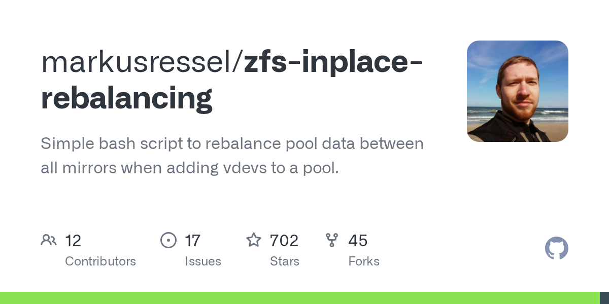

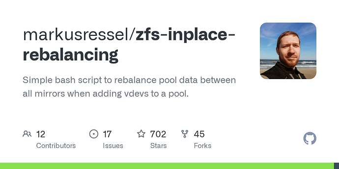

And if you really just want to do it in place this likeky works. I’d snapshot first though, and delete the snapshot upon confirmation I like the results.

And again you could always just run the rebalance script that I linked which should do what you want - although again I haven’t tested it because I have no need for it. I’d prrobably run it on individual directories rather than on / from a live ISO.
