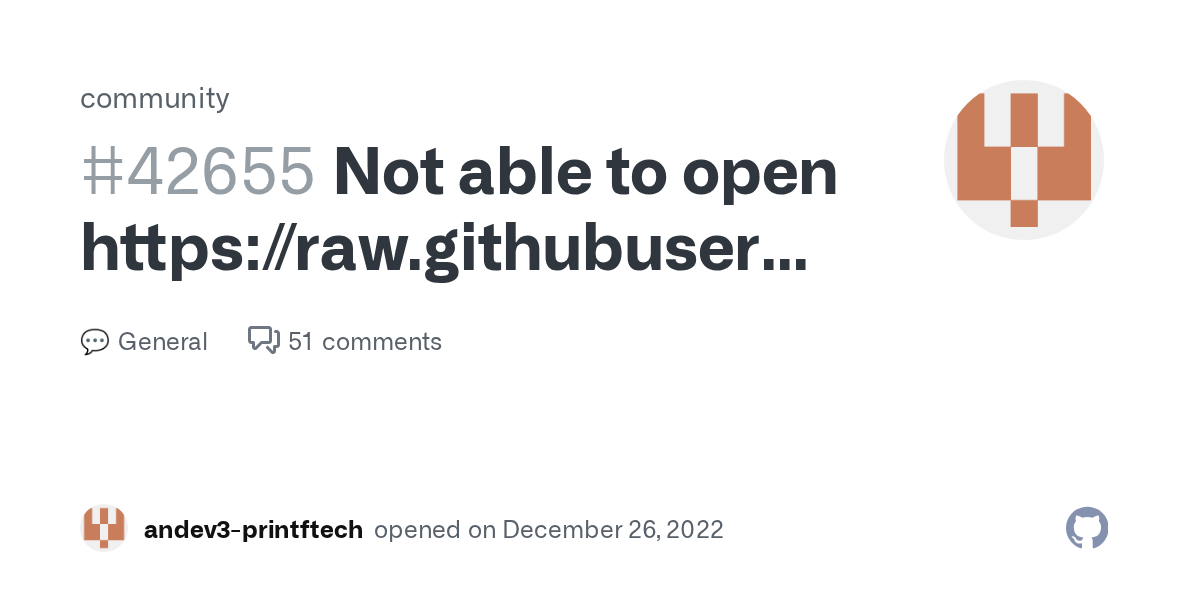

The https://raw.githubusercontent.com/xpf0000/PhpWebStudy/v4.12.2/LICENSE URL is reachable so there might be some problem with you being blocked from github or by your ISP or similar.
Can you resolve the address in your browser?
This is unrelated. :wink:
Thank you, well noted as regards the screenshots, it was one of the things we do in Windows world to give the support-person on the other side a clear view of the error we were experiencing.
I had tried different network with no success. How then do I get unblock by github?
edit:
I can login into github both from browser and terminal.
@cscs and @kindofabuzz I realized using VPN on Chrome broswer I was able to access the license url.
Searched online and found this link on how to resolve the issue of unblocking:
then entered this.
sudo bash -c ‘echo “185.199.108.133 raw.githubusercontent.com” >> /etc/hosts’
Changed the DNS to DNSPod(Tencent) and used my wife’s network. It worked and fully installed now.
