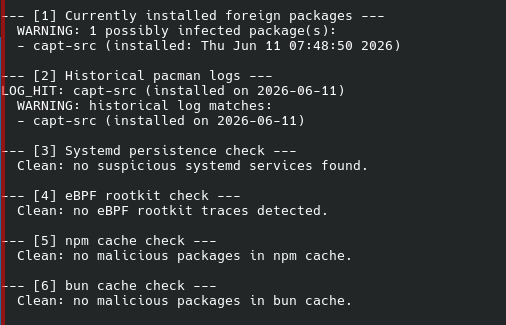

WARNING: 1 possibly infected package(s) found:
  • capt-src
Should i revome it?
I installed it on 11th Jun
Thanks for clarifying what’s going on :slight_smile:
This script partially clears you.
I’d suggest installing Traur to assist flagging up any potential issues as you update any AUR packages too.

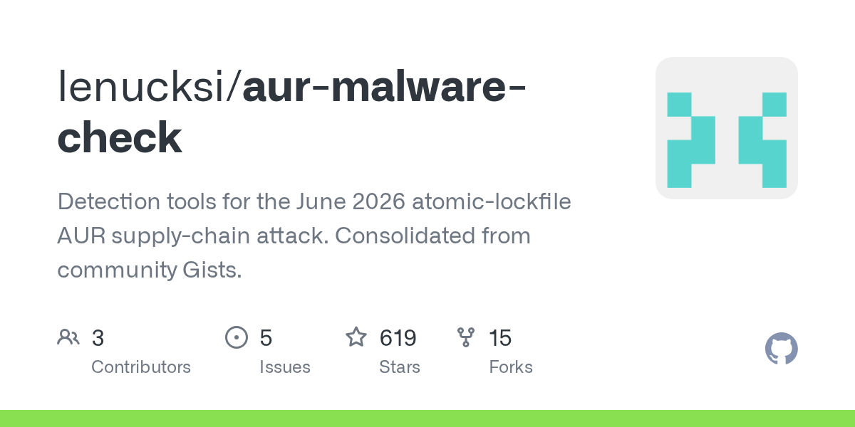

Here’s another one you can try:
git clone https://github.com/lenucksi/aur-malware-check.git
cd aur-malware-check
chmod +x aur_check.sh
./aur_check.sh --full

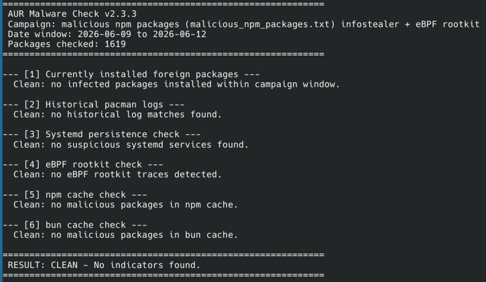

This includes an npm scan… output looks like this:
Summary
 AUR Malware Check v2.3.3
 Campaign: malicious npm packages (malicious_npm_packages.txt) infostealer + eBPF rootkit
 Date window: 2026-06-09 to 2026-06-12
 Packages checked: 1619
--- [1] Currently installed foreign packages ---
  Clean: no infected packages installed within campaign window.
--- [2] Historical pacman logs ---
  Clean: no historical log matches found.
--- [3] Systemd persistence check ---
  Clean: no suspicious systemd services found.
--- [4] eBPF rootkit check ---
  Clean: no eBPF rootkit traces detected.
--- [5] npm cache check ---
  Clean: no malicious packages in npm cache.
--- [6] bun cache check ---
  Clean: no malicious packages in bun cache.
 RESULT: CLEAN - No indicators found.
The most critical risk is that you have an eBPF rootkit, and can survive if you remove that package.
For now, I’d suggest your credentials are at high risk - any SSH keys, website passwords, API tokens…
Personally I would get my USB out and do a clean install now, restore my backups and waste half a day getting it back up to scratch.
After that, monitor your accounts for suspicious activities?
oh wow now i need to run a .sh that i don’t trust to see if i’m infected, ok i guess.
It’s all there… public. Read the issues and comments.
The maintainer of the cachy paste updated it to pull from both the Arch list and this repo, as well as CSCS list.
i suck at using github, i get it’s legit but i’m such a scaredy-cat
